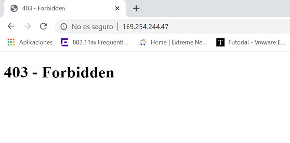

I have an AP510i in standalone mode but I can't see the web interface to configure it.

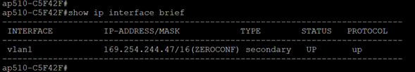

This is the IP that I am connecting to according to the manual.

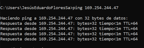

I already have connectivity between the laptop and the AP.
But when I try to infest from any browser, it throws the following error.
Does anyone know if I have to enable a service in order to manage the web interface.

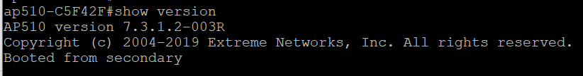

Hello Jesus,
As Mig said, you probably have a LEAN image on your AP. You cannot differentiate between the 2 once installed. I would recommend you upgrade to the latest 7.3.1.4 firmware and not reinstall the same version. Make sure you select the full and not the LEAN version.

‎07-18-2020 07:16 PM
Thank you very much Miguel, my question is going to sound very silly but how can I differentiate between the LEAN version and the STANDARD version. This is the version that my AP has.
Again, thank you very much.
‎07-18-2020 07:30 AM
Jesus,
This is certainly due to the fact that the AP has been preloaded with the LEAN firmware.
You must upgrade it with the full image to have a web UI interface.
Mig
