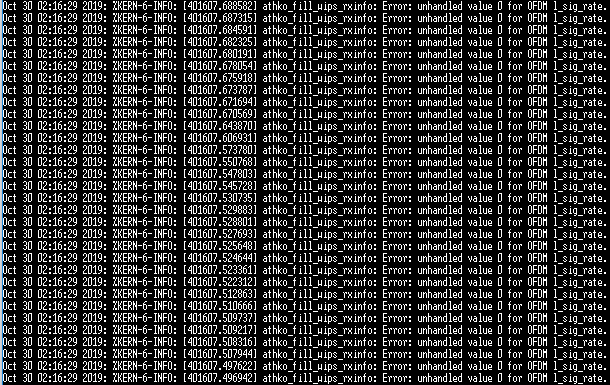

Hello,
How can I debug the following message ?
Oct 30 02:16:29 2019: %KERN-6-INFO: [401607.670569] athko_fill_wips_rxinfo: Error: unhandled value 0 for OFDM l_sig_rate.
Solved! Go to Solution.

07-16-2020 09:41 AM
I’m running the version 5.9.7.0-011R and the error message is still there.
“athko_fill_wips_rxinfo: Error: unhandled value 0 for OFDM l_sig_rate”
Can it be because: rate-selection opportunistic ? (I use this beause of the MESH config.)
