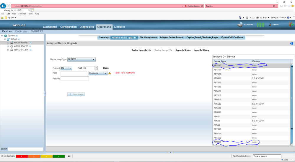

‎01-13-2020 06:40 PM
Hi Chris,
See the attached below. Its NONE! so how can help me about this.
‎01-13-2020 06:42 PM
Without a support contract, there’s nothing I can do to help with getting firmware for the APs.
