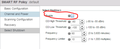

Solved! I erased startup config. Smart RF works fine now!

Hi Richard,
Based on your initial screen shot smart-rf is not running.
Note:
All APs should not be on channels 1 & 36.
If code is lower than 5.9.0 i would advise an upgrade to later code.
If on 5.9.2 and above please un-check select shutdown
Can you also re-enable neighbor recovery?
If after 10-40 minutes of making the changes you are not seeing any changes please clear the smart-rf config.
Operations-> smart-rf ->
Note:
