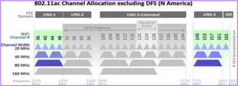

What are the 5Ghz non-DFS, non-overlapping channels?
Laura4
New Contributor II
23 REPLIES 23
dflouret
Laura,
Hope this helps
Ronald_Dvorak
Honored Contributor
Looks fine to me...
Laura4
New Contributor II
So if I were to use 5Ghz, non overlapping. non DFS channels at 40MHz, I could use 36 , 44, 149, and 157? Would that work?
