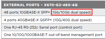

On the same note, I do not seem to be able to set any ports to 100M with auto-neg.
Slot-1 Core.44 # conf ports 2:33 auto on speed 100
Error: Speed specified is not supported on port 2:33.
We have some legacy devices that only support 100M. If I configure 1G, is this the maximum and therefore it will negotiate down to 100M, or will it only negotiate to 1G?
Alexandr_P
Valued Contributor
Summit X670 do not support 100Mbps.
You can find this in the Data Sheet, HW Install Guide etc.
