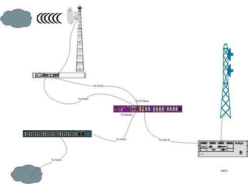

hello Dears,
could you please give support to my for this task .I have eXtreme switch type Summit X450-24x DC in my network. i want to know how I can make one port Master and another one port a slave , it will working automatically when the master go to down? kindly see the attached image.

Thank for your replay. I want port3 active work as master and ports 1,2 backup work as slave . that mean when port 3 go to down immediately ports 1,2 go to on.

for redundant network:
configure por 1 redundant 2 link on. when port 1 goes down port 2 immediately is active
