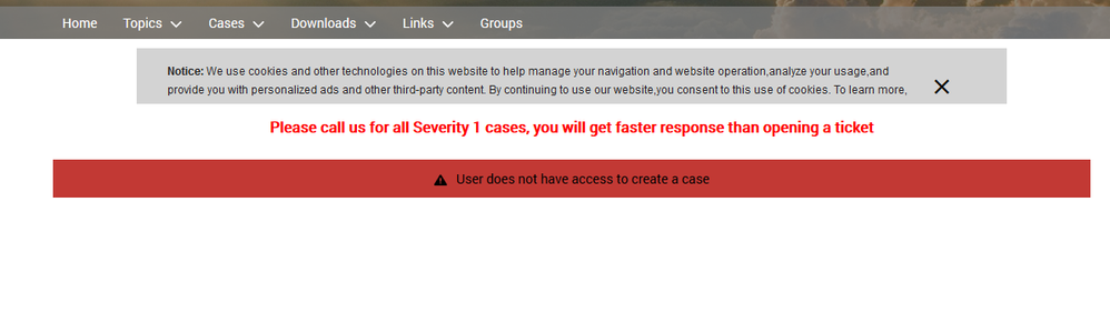

Hi @Sam Pirok​ I'm getting following error when I try to open a case

Thanks for letting me know, at this point we're going to need a case for more in depth troubleshooting. Would you be able to open a technical support case for this issue and link this conversation so the technician can see what we've discussed so far?
