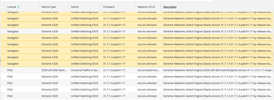

Hello!
I have a bunch of 5320 stacks in a customer being identified as navigator instead of pilot. There are enough pilot licenses to accomodate all of them. To make it more confusing other 5320 with same OS version, same config, same oid, same vendor profile etc are properly identified as pilot.
I have tried to delete the device and recreate it, unmanage and manage it, nothing makes a difference, some devices, always the same devices, are identified as navigator.
Site engine version is 24.07.11.22. We just upgraded trying to find a solution to this issue that we have been experiencing since version 23.X , among others.
I am aware of this article it didn't help devices with pilot and devices with navigator share the same vendor profile.
This is a screenshow where I tried to show relevant data to demonstrate that devices are as equal as they can be, only the configuration may be different since they are in different sites.

Exactly how did you rule out the Vendor Profile issue per that article? The article does not exactly detail how to reset vendor profile data (and it should).
The Device Type column says it all.. there is a custom vendor profile for this because "Extreme 5320" is not a default vendor profile / family in XIQ-SE.
Reset vendor profile cache via Administration -> Diagnostics -> (level: Advanced) -> System -> Vendor Profile Cache -> Restore to Defaults. Please note ALL VP customizations will be lost here. Unfortunate but necessary.

Hmm, thanks Robert, true, I assumed that all 5320 where default vp because same vp chose license randomly. My fault.
I didn't mind other VP because they shouldn't be there at all.
This was actually our solution. Thanks a lot!!!!!
