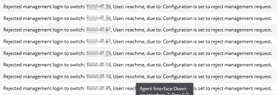

We are bombarded with these rejected events. This is working as designed, correct? All of our VOSS switches are set to check reachability every 3 minutes. It seems odd that the check is performed with a rejection, maybe that's standard procedure.
Is Status-Server mode any more efficient (RFC 5997)?

‎11-01-2023 05:23 AM
Yes, this is normal, for reachability it does not matter if a reject or accept is received, as long as a radius response is received.
You could create a seperate rule to just accept this and not see the rejects.
server-status might be a more silent method
