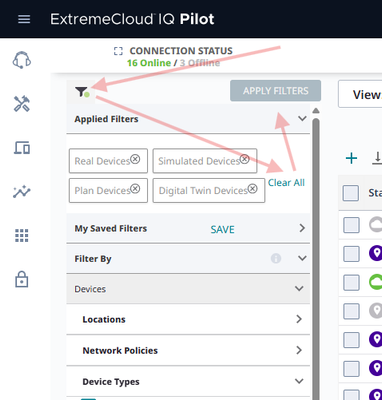

Make sure you have no filters applied that would skew your view,  clear all potential filters.

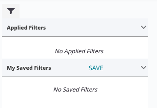

No filters at all. I can see another old AP i just tried to onboard but not this one. If i try to add it i get the "already onboarded" error message. I tried to reset the AP, nothing changes. Before resetting I noticed the VIQ was different from my cloud instance, therefore i guess there is a wrong assigment on the cloud side
