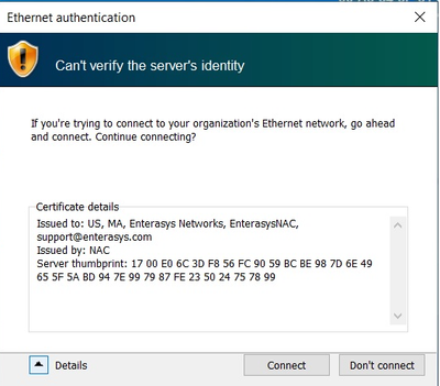

We have recently setup 802.1x auth and are using EAP-TTLS auth method. We seem to have it working with our Windows 10 clients at this stage of testing, but I keep getting this popup window titled Ethernet Authentication "Can't verify the server's identity".
I think there is a step we missed when setting up our certificate infrastructure. Do we need to register a certificate for each of our ExtremeControl RADIUS servers (we have 15 total) with our certificate authority (internal active directory domain controller). I know just enough about certificates to be dangerous, but I "think" the client get this message because the server is not "registered" with our CA and therefore the client can't verify the RADIUS servers identity. Just need some guidance on why this is happening and what would stop it. Also, if someone has setup their windows environment to use 802.1x with ExtremeControl servers and EAL-TTLS, please let me know if there is some step-by-step guide out there to follow. Thank you.

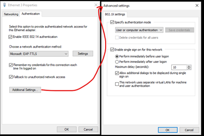

Also, when it comes to the settings for our client supplicant setup, here is what I have been using.
How does this look? It seems to work fine and our 802.1x rules are working so far.
‎10-07-2023 04:01 PM
I would need to test it in the lab to be 100% but, I'm assuming that if that profile is manually created on the client you'll be OK. The problem with certificate validation/server identity trust is typically seen when Windows tries to setup the wireless profile on initial connection.

‎10-03-2023 05:22 AM
You appear to be using the default self-signed untrusted certificate that ships with Extreme Control. This certificate is not trusted by any device so the warning presented to clients to 'verify' if they wish to Connect or Disconnect is valid.
You need to replace the certificate with a trusted certificate chain signed by a trusted certificate authority or private CA if these devices are GPO/managed.
This link will walk you through the certificate CSR and signing process @ https://extreme-networks.my.site.com/ExtrArticleDetail?an=000078322.
