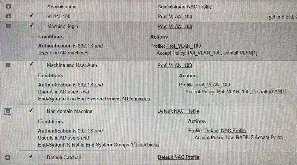

Looking at those screens I see:
  1. From the rules: “Machine and User Auth” is expecting “End-Systems Groups AD machines”
  2. From the evaluation tool: “Th Host ...doesn’t have LDAP attributes..in this inclusive LDAP Host Group End-Systems Groups AD machines”

Hello SDR,
your maschine is matching IS NOT in End-System Groups AD machine
and is not matching IS in End-System Groups AD machine
=> Are you 100% sure that the maschine is in the expacted AD group?
That’s why I ask if you can see if the client is in the group (with the LDAP test tool)
Regards Stephan
SDR
New Contributor III
See below - as we are still testing, we did not focus on the “actions” (profiles)
