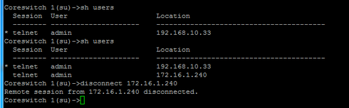

03-15-2017 09:01 AM
# disconnect
03-15-2017 09:01 AM
thank you,but I have tried this method, but I can not clear the telnet session with the disconnect command,The disconnect command has no effect
