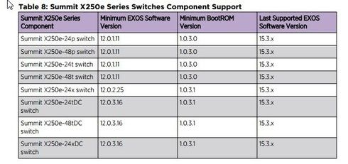

Hi all, I wish to know if a x440 is supported in a stack with four x250 switches. Would i have to upgrade my x250 stacking? Thanks.

Hello Agustin
Yes you can stack the 440 with the 250 as long as you have 15.2 or earlier code. The 250 is not supported after 15.2.
Does that help?
