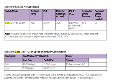

Contributor II
Hy Chris,
Sorry, it is the 24port version (System Type: X435-24P-4S)
it has a fan, but the rpm is not measurable.
no rpm output in the cli. in snmp the number is huge

CThompsonEXOS
What model is that x435? the 24p should have a fan:
