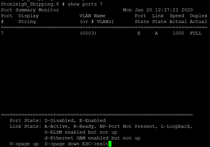

So I’m a new user here in the EW forums. So recently I started a new job and inherited the Extreme Wireless system. The downside is, there’s no documentation (long story) and I’m having an issue with a X430 8P.
Only a few ports work on the X430P (port 5, 8, and 10). I’ve checked all the other ports are enabled (they’re Enabled and Ready) but yet nothing will work to get them to actually work. I’ve added them to the VLAN(s) and still nothing.

01-24-2020 06:15 PM
So just making sure I have this right;
Step 1 - Putty into the X430P.
Step 2 - Since I just need all of the non working ports to act as normal Ethernet connections, I’ll go to all of the ports that aren’t working (1,2,3,4,6,and 7) and run the command
Con vlan 30,31,60 add port X tagged
I think I did try that with Port 7 a few days ago but even when added to the VLAN’s I got nothing. Si maybe I used the wrong command?
EDIT: I’ll be back on prem either Monday or Tuesday and can recheck everything then. I could be mistaken.
