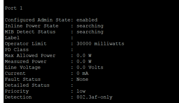

‎09-03-2021 02:09 PM
Hi
So I disabled then enabled POE on port 1.
Then I checked the status again and got this:
The AP in Port 1 is still not receiving POE.
