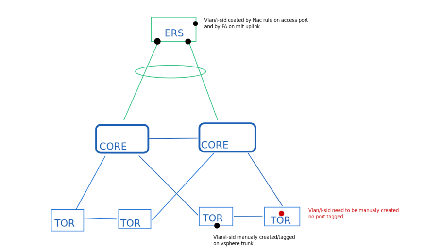

‎02-16-2024 07:18 AM
Hi Darvid,
If your TOR devices are in virtual-ist cluster mode, you need to define vlan/i-sid association on both members.
Because, through the fabric, trafic is send to the cluster system-id (virtual b-mac) and not to the vsp system-id. By the topology, if packet comes to second cluster member (the one without vlan/i-sid association) the packet is dropped.
So you need define vlan/i-sid association on both cluster member even if servers are connected on only one member.

‎02-16-2024 04:45 AM
Finally found my mistake, but don't really undersand !
Bellow a little nice diagram :), blue is spbm vsp
Vlan/i-sid must be manualy created on the second Tor (red)
although it is not used.
How is it that i-side does not transit automatically like on COREs ?
