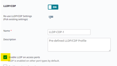

SSH into the AP305C and run the following commands:
show system power mode
Show system power stat
This will tell you if the APs are operating in 802.3AF or AT power. If operating in 802.3af power, then there is your issue, the AP460 need AT power. You'll have to go back to the switch to check the settings but before doing that you can also run the following command on the AP305C:
show lldp
of lldp is enabled then your settings are correct but if not then you'll have to enabled lldp in the network policy and make sure that the  "Enable LLDP on access ports" box is checked:

LLDP is enabled ok. I run the 2 commands the next time I'm out at the site:
show system power stat
Is there a command to force 802.3AT on a switch port?
