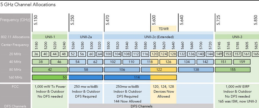

‎07-13-2021 01:48 AM
base on the image you posted, If choose 40Mhz channel width, then the center point of channel should be 38, 46… 151, 159 etc, but here is the result of `show acsp`
Interface Channel select state Primary channel Channel width Power ctrl state Tx power(dbm) Use Last Selection
Wifi0 Disable(Link down) Down 20 Disable(Link down) Down Channel:No Power:No
Wifi1 Enable 157 40 Enable 14 Channel:No Power:No
the channel is 157, how to determine if 157 is bonding with 161 or 153?
‎07-12-2021 03:32 PM
P.S. According to your question in the topic, please try to avoid reusing same 20 MHz channel or overlapping bonded channels as long as it is possible:
Grabbed the above image from the interwebz.
Cheers,
Tomasz
