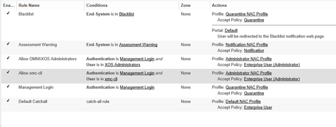

Now I am trying to figure out how to add a second rule that will allow the local xmc-cli account on the switch to be able to login as well. This logic doesn't seem to do it.
I don't think that is possible because of the rule before = NAC checks LDAP and it doesn't match and that answer is send back to the switch = failed authentication.
The request never get's to the second rule.
