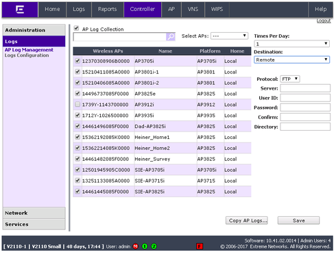

Or use the AP log mgmt to upload all AP logs 1,2,4 or 6x per day to local or remote....
‎01-12-2018 05:28 AM
https://gtacknowledge.extremenetworks.com/articles/How_To/How-to-Collect-Access-Point-Logging-Inform...
Run your test then generate your log from the GUI, trace bundle includes the ap.log
