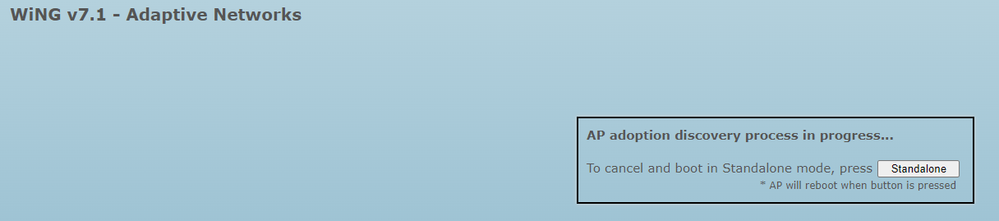

Hello everyone,
I'm new with ExtremeNetworks products, I just bought an AP305C-WR.
I just followed the video How To: Onboard an Access Point - YouTube , created an ExtremeCloud IQ account, and registered the SN.
After connect the AP to the network, nothing happens...
If I SSH, I can see the message:
"login as: admin
admin@192.168.1.239's password:
BusyBox v1.17.4 (2020-12-08 22:53:31 PST) built-in shell (ash)
Enter 'help' for a list of built-in commands.
AP305C-WR 7.5.1.2-005R interactive shell for service personnel only
AP adoption discovery process in progress...
To cancel and boot in Standalone mode, type (s): "

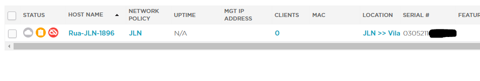

In XIQ portal

The device OS is already set to WiNG mode and regarding "step 4" I dont have any XCC...
RobertZ
Seams that you have a XCC controller on your network, please follow the below KB, specifically step four.
How to switch Universal AP operational modes between HiveOS Cloud (XIQ) and WiNG modes
