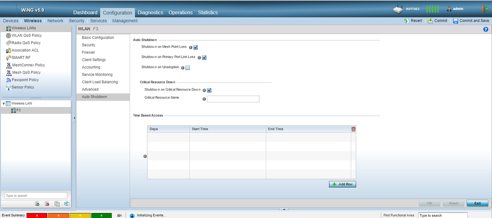

Function auto shutdown how does it work? I disconnect the network but the SSID was not turned off.

The Auto Shutdown feature causes the WLAN to shut down when certain criteria are met. It also allows administrators to set the operating days and hours of certain WLANs for security or bandwidth purposes.

It seems that the radio still transmit the WLAN but the client isn't able to connect to this WLAN.
