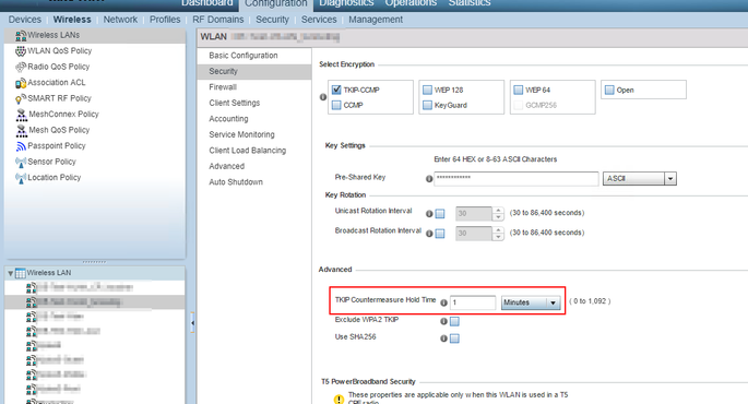

you say, all clients lost the connection. do they lost the ip connection or really the wlan association?
If all lost the wlan association, do you use tkip encryption on the ssids?
by default, if there are tkip-countermeasure errors, the wing setup blocks the bad client for a minute and kicks out all others to re-associate/authenticate.
maybe there are messages in the log for this.
also i suggest to set the time to 1h (1min is defined by the standard)

Thank you for your answer, as a matter of fact we are using TKIP authentication on one of our SSIDs the other use WPA2 and we exclude WPA2-TKIP.  All clients lost wlan association at the time of the issue (both SSIDs)

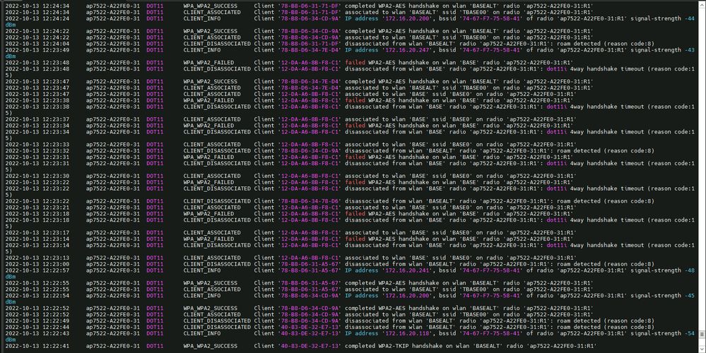

I searched the logs but I didn't see any signs of countermeasures, however a few days ago we changed the security key on the WPA2 SSID and on the logs I saw many disassociations due to failed key (4 way handshake timeout)
I'm not shure if this could be triggering the countermeasures or not.
However, regarding the Counter measure hold time setting.   What does this setting exactly do, because when the general disconnection event took place it took about a minute (but no more than 2 minutes, actually nobody exactly know) to everybody be able to reassociate again; on PDTs it automatically reassociate but on certain Laptops it was necesary to manually reconnect to SSID
My concern is that this setting could increase the time the system takes to recover and allow the clients to reconnect again given the disconnection event takes place again (god forbid).
