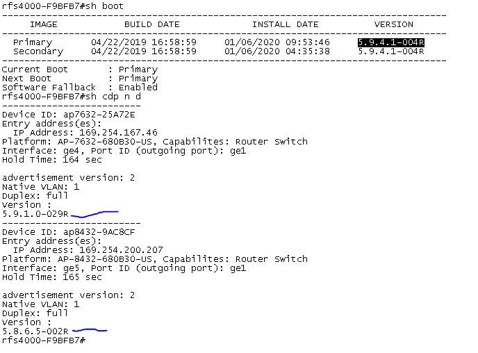

Hi Chris,
Please see this for ap7632, its already upgraded but the ap8432 isn’t ? so at least the first one would be ok with the controller which is 5.9.4.1-004R?

‎01-13-2020 05:23 PM
The 7632 is NOT matching. It’s 5.9.1.0….and the controller is 5.9.4.1
