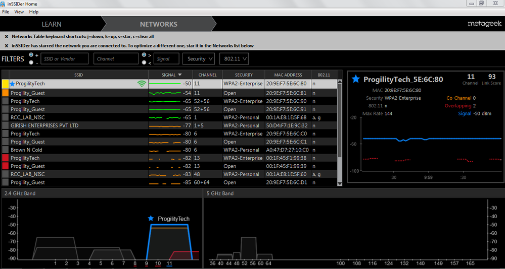

I tested with inSSIDer app on one of the working windows machine. Please find attached snap. It is showing that my SSID “ProgilityTech” using channel no. 11

01-13-2021 03:02 PM
First of all you can check if the cause is the channel. You can install a programm on an working client to see the channels used by the AP. For example you can use the software inSSIDer it is still available in a free version.
If you have the used channels in the air and then you can take further steps if necessary.
In 2.4 GHz use channels 1 to 11 which are supported in all countries.
