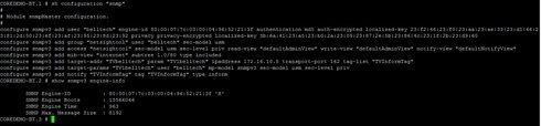

I need to configure events in the logs of the switch and also that these are replicated to NetSight as I set these alerts on Switch Extreme and that can be displayed in NetSight?

Would you confirm if the SNMP community information on the switch match the community credentials you are using in NetSight to communicate with the switch?

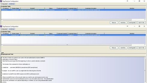

In the Trap Receiver Configuration window, there is an error in the Status field. I cannot read all of it. It says "Error 100 - All..." Would you let me know what the complete error message is?
Also, In the Trap Receiver Configuration window can you click on the SNMPtrapd tab and verify that the "engine id" value matches what is configured on the switch? To get the engine id value on the switch enter the command "show snmpv3 engine-info". If there is no engine id in NetSight, you can click the 'Get EngineID' button.

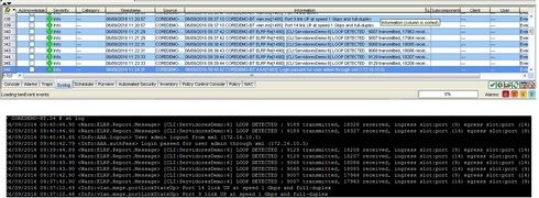

I already appear in the events Syslog alarms, but does not appear in the Traps and Alarms also in the Console do not appear, but I falata to tune?
Acting aveidencias events in the Log Switch but do not appear in the console alarms NetSight
