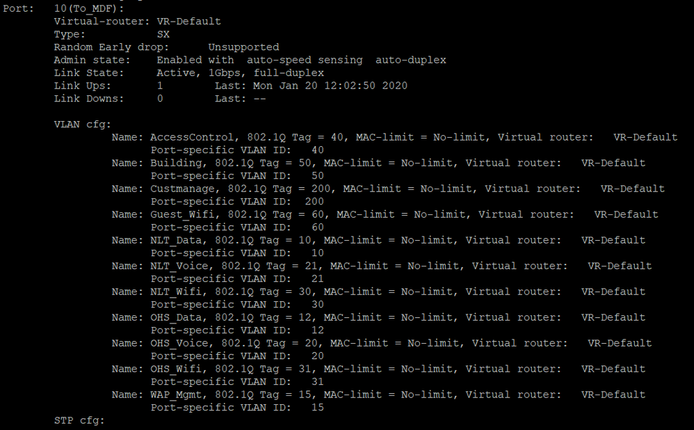

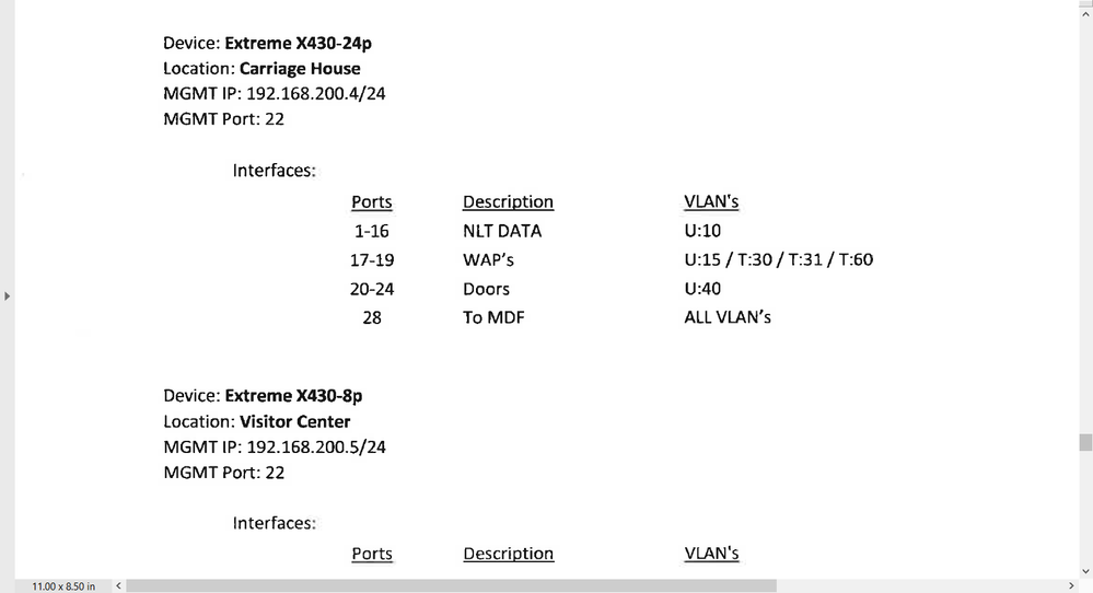

We have several VLANS (please see below).
Our setup is pretty complex and I know we have a different management IP for each deployed device. For instance the Carriage House (where I’ll be tomorrow) is different from the Visitor Center Management IP. So I’ll use that Carriage House IP tomorrow, correct?

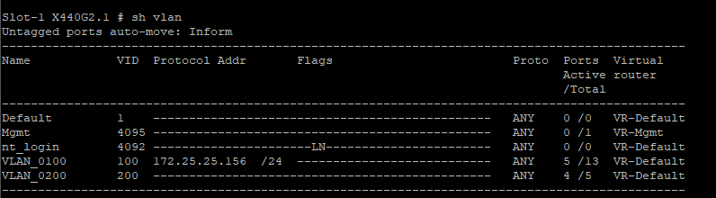

The easy way to check that is to connect to one of your other running EXOS switches and do a “show vlan” and see on which VLAN the IP is configured.
e.g. that is one of my test switches - as you’d see the IP is set for VLAN 100 which is also my access VLAN for my clients - it’s a test switch so I don’t care if mgmt traffic is on the same VLAN as the test user traffic.
In a real installation you’d normaly configure a new mgmt VLAN that could only be accessed by the department that manages the infrastructure to avoid access by normal end users.
So for my above example I’ve used the following commands to config the IP…
# configure vlan 100 ip 172.25.25.156 255.255.255.0
# configure iproute add default 172.25.25.254 vr VR-Default

Thanks @Ronald Dvorak you’re right I should. I’m very new to Extreme Switching and this location was given to me to take over IT management for, and there was no documentation. So I’ve had to not only teach myself Extreme but also teach myself/document the IP scope, VLAN’s, etc.
So as a game plan for tomorrow;
Step 1 - I’ll try to add the SFP to see if that helps
Step 2 - If it doesn’t I’ll add the Management IP address & subnet mask, and then VLAN 30 so I can finally get this WAP working.
I’ll let you know how I make out.
