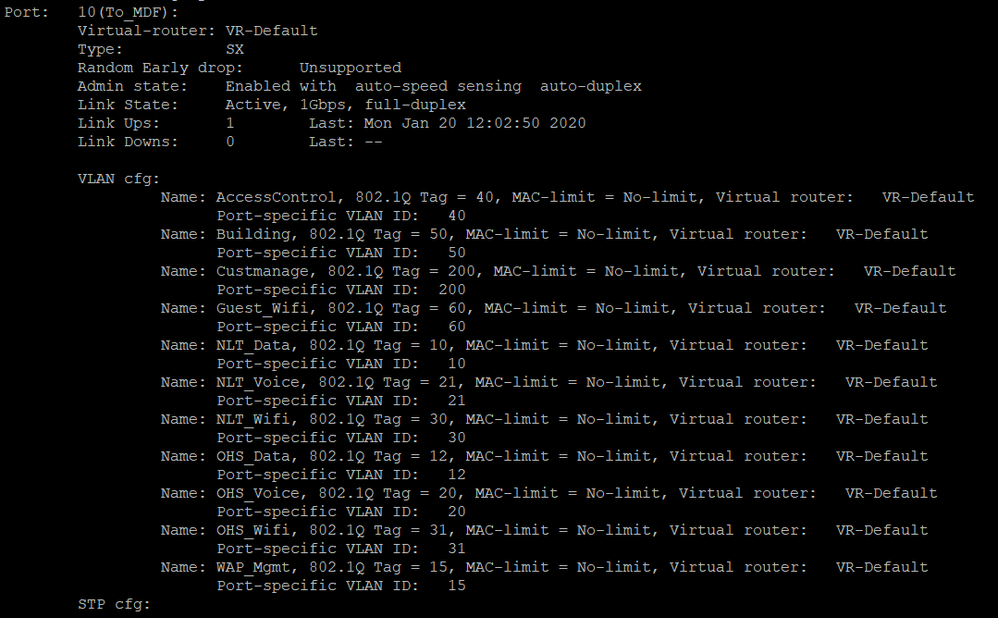

Anyways here’s our list of VLANS;
and here’s what happens when I try to add the VLAN WAP Mgmt I get this error.
I’m 99% sure the issue is with the X430. Meaning it wasn’t programmed right by the previous MSP and thats the missing piece.
