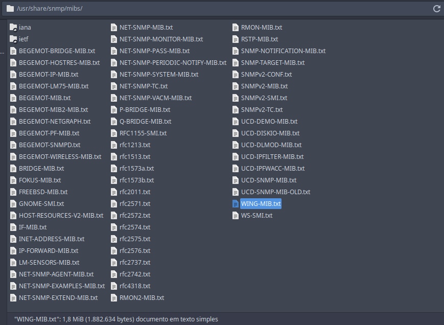

I got the MIBS file, but now the difficulty is to search for the information that the controller provides through SNMP.
I copied the mibs to the /usr/share/snmp/mibs folder of my ubuntu and ran the command below.
$ snmpwalk -M +/usr/share/snmp/mibs -v2c -c cti 172.16.15.1 1.3.6.1.4.1.388.50.0.4
SNMPv2-SMI::enterprises.388.50.0.4 = No Such Object available on this agent at this OID
$ snmpget -M +/usr/share/snmp/mibs -v2c -c cti 172.16.15.1 1.3.6.1.4.1.388.50.0.4
Does this result mean that the OID exists, that the controller returned the command, but did not find any data?
