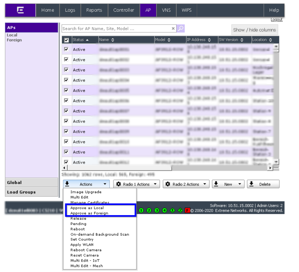

12-21-2020 07:12 AM
Hello NetWolf,
first of all it doesn’t matter if the APs are using the 1st or 2nd controller as primary. If you spread the APs over both controller you have a loadbalancing accross both controller.
But you can move all or parts here:
If you want all APs to be active on the 1st controller. Go to the 2nd select all APs and select “Approve as Foreign”. Then the APs will use the 1st controller as primary.
